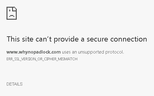

I’m struggling with weird problem with a site that I can not resolve. When I access the main domain using https - without using www - the page loads without problems (or with mixed content notice), but when I use www it appears a warning in several browsers. In Chrome the warning is: ERR_SSL_VERSION_OR_CIPHER_MISMATCH. When accessing subdomains there are no problems.
In ssllabs.com the site has overall rating A in all situations, but when I add www to the main domain it appears the warning: “Failed to communicate with the secure server”. How to solve this?

Test addresses below and check it out. If you test main domain will give error - with or without www - because the CMS is Wordpress and is set to serve pages with www.
OK I see the problem now.
Even if I adjust the IP (manually) to point the WWW to the root domain, it fails to connect securely.
The reason for this is unknown to me…
