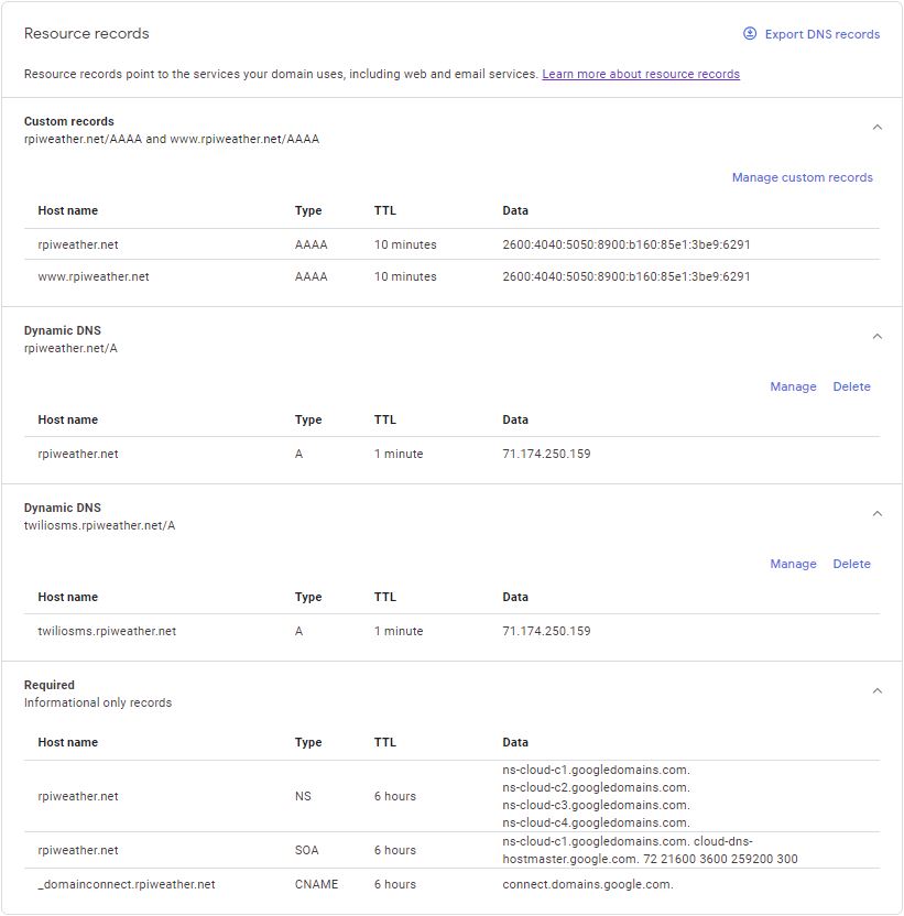

I just added a AAAA record in Google Domains, does this fix the IPv6 problem?
No, your IPv6 AAAA record IP address looked wrong and still is. See below and click rerun test to check again. You might be better off deleting the AAAA. And add it back when you understand it better
I got this today regarding the IPv6 compatibility:
It seems the IPv6 issues has been mostly resolved. The last issue is the "Could not connect to rpiweather.net on port 80 over IPv6." Does this mean I should be forwarding port 80 to 443 on my router?
www.rpiweather.net is still not reachable. This is what I have on my Google Domains DNS records:

Not at all. What is important now is the connection to your nginx server. Please use Let's Debug (https://letsdebug.net) to test that connection. It is perfect for that (and it currently fails the same as it did earlier).
Here's a few things to start with
Your DNS for the www subdomain only has an IPv6 address defined and it is not working to reach your server. You should add an A record for your IPv4 to that subdomain so it matches your root domain
The AAAA record for both your domains has the same IPv6 address but that address is failing to reach your nginx server.
You can determine the correct IPv6 address many ways. One way is to run this command
curl -4 https://ifconfig.io
curl -6 https://ifconfig.io
Whatever is returned for the -6 command belongs in your DNS AAAA record.
If there is no value returned then you should remove the AAAA record from both domains.
The value for the -4 belongs in the A record for each of your domains (currently correct for your root domain but missing from your www subdomain)
Ah ha! Look at this, on my Raspberry Pi I get this result:
pi@HomeAutomation:~ $ curl -4 https://ifconfig.io
71.174.250.159
pi@HomeAutomation:~ $ curl -6 https://ifconfig.io
2600:4040:5050:8900:b176:3528:f70d:7c67
But on my laptop I get this:
C:\Users\micha>curl -4 https://ifconfig.io
71.174.250.159
C:\Users\micha>curl -6 https://ifconfig.io
2600:4040:5050:8900:e076:d08f:f264:844f
Same IPv4 addresses, but different IPv6 addresses, why is that?
I just now changed the Google AAAA records to match the RPi address and I got this:
So I'm all good now?
