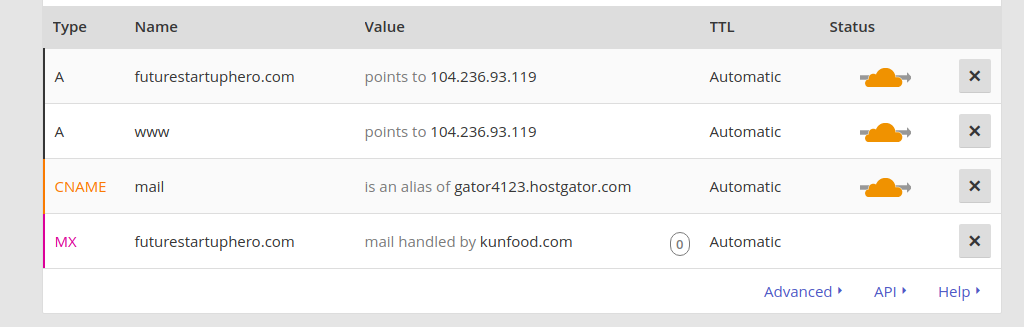

DNS resolutions I do with CLOUDFLARE, and everything goes well according to what I see, if you could guide me how to solve this problem ?.
I attach my DNS record
You’re using Cloudflare not just for DNS but also for its reverse proxy functionality. This means that when a browser (or the Let’s Encrypt validation server) connects to your domain, they actually connect to Cloudflare rather than your server which appears to be on Digital Ocean.
This means:
  1. You need a certificate on Cloudflare’s proxy for HTTPS to work for your users. Cloudflare provides this as a free service, you just need to enable it (and in fact it seems you, or they, have already done so, as your site is currently available over HTTPS with their provided certificate). This secures the connection from your users to Cloudflare’s proxy.
  2. You probably also want to secure the connection from Cloudflare to Digial Ocean. You can do this with a Let’s Encrypt certificate, but it won’t work with the --nginx plugin because that relies on your server controlling the TLS endpoint (when in fact Cloudflare controls it). However you should be able to use --webroot or -a webroot -i nginx instead. Alternatively Cloudflare provides a service that they call “Origin CA” which can be used for the same purpose.
Sorry I can’t provide more detailed help as I don’t use Cloudflare myself.

You can do this in Cloudflare itself, at least the HTTP to HTTPS bit can be done by enabling the "Always use HTTPS" setting. They also have page rules that can be used for the other redirects, apparently.
If you prefer to do it with nginx, I think (if I'm reading this correctly) the best route may be to set up Let's Encrypt first, to encrypt the connection from Cloudflare to Digital Ocean, and enable "Full SSL (Strict)" mode in Cloudflare. (You may want to do this anyway for better security, and certbot -a webroot -i nginx can do some of the configuration work for you). After that I believe you should be able to get the redirects working by following any standard nginx redirect tutorial.
