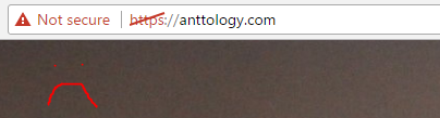

I’m tried to installed a SSL-certificate via certbot and just let him do his thing BUT although I get the message with something like: congrats… successfully install… expires on the DATE
but now if I try go to my website it still is http. I read that certbot maybe did not update/add the paths for apache2 but I don’t know how to do that.

Seems like the site is available now but it uses my selfsigned certificate instead of the one certbot made. How can I change this?
Also! How can I make the http version unavailable for public? so if people only enter anttology.com manually that they get to https instantly without having to type it themselves? Now if you go for anttology.com you get to the http version which now is “empty”
