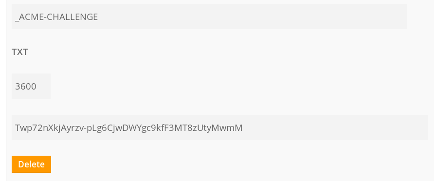

I have entered below values while creating TXT record,
Name: _acme-challenge.veplopenhab.ga or veplopenhab.ga
Target: Twp72nXkjAyrzv-pLg6CjwDWYgc9kfF3MT8zUtyMwmM

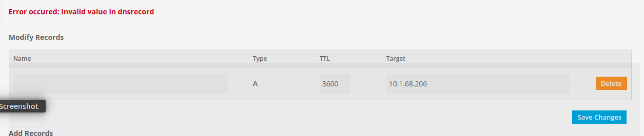

I am getting below error,
I was able to enter your record into a domain in Freenom successfully.

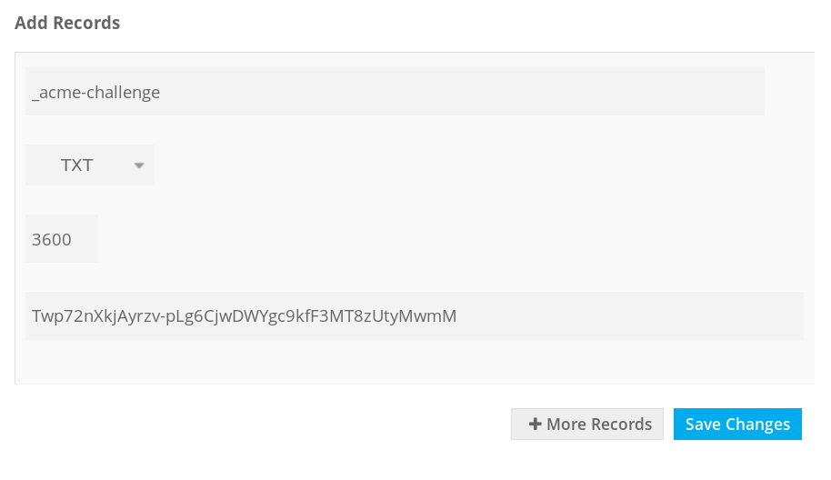

See the screenshot:

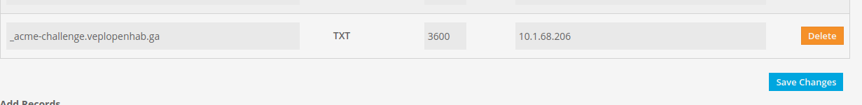

resulting in:
You mean you have created a record for me in your account.

No, I can't control the records for your account. I'm just showing you the successful way to use the Freenom interface. You need to do it yourself.
and after you do it, wait a couple of minutes before continuing, as there is some delay.

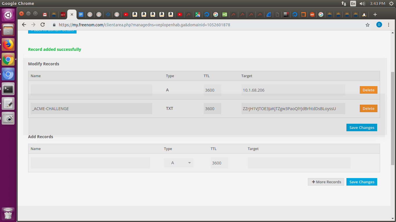

I have added record successfully,
That’s great. I can see it is visible in DNS, so if you proceed now, it should succeed to create a certificate.

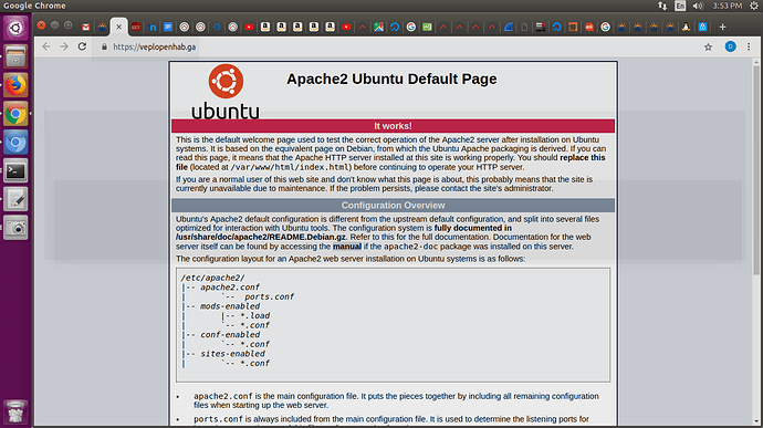

It will solve this issue image
It will solve that issue whether you use a redirect or not. The option is about forcing HTTPS.
You can enable it if you want, it’s easy to get rid of (or to add) at any time.
Once you’re done, you should be able to visit https://veplopenhab.ga and it should not complain about security.
