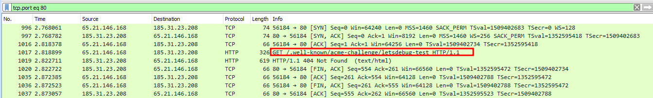

Hi again,
To help clarify the situation, I'm attaching two Wireshark captures taken from the WAN interface, before any local filtering or firewall rules are applied.
Both captures are the result of running Let’s Debug tests:
  • Capture 1 shows a successful inbound request from Let's Debug to one of our VMs that can successfully issue certificates.
  • Capture 2 shows traffic to the problematic VM (cerb00apps.onesoft.es), where no incoming request from Let's Debug is observed at all.

did you handcrafted the ACME client? GuzzleHttp/7 is some PHP HTTP client GitHub - guzzle/guzzle: Guzzle, an extensible PHP HTTP client to build on not a acme client by itself
Have you kept port 80 open? It's still looking like nothing can connect to me:
If you're looking in logs, whenever you ask Let's Encrypt to validate your challenge (whether directly, or Let's Debug asking the Let's Encrypt staging system), you should be seeing at least 5 requests coming in. If you're not seeing them, then something is blocking them. If it's not on the server you're looking at, maybe it's a firewall or network further upstream.
You mention that you do intentionally block some IPs, so here's some information on blocking in general and how Let's Encrypt needs to check from multiple places around the world, in case that's helpful to your understanding of how the process works:
Yes, as mentioned earlier, we're using the afosto/yaac library, which is a PHP ACME client that builds on top of Guzzle for HTTP requests. So while Guzzle appears in the logs, it's just the underlying HTTP client — not something we’re using directly to interact with the ACME server.
Apologies — our system is configured to open port 80 only during the certificate request process, and it closes it immediately afterward. I've now opened it again and will keep it open to avoid further issues.
As I mentioned earlier, we’ve captured all incoming traffic directed to the server before any firewall rules are applied, and we’re not seeing any requests coming from Let’s Encrypt during validation attempts. In contrast, we do see requests coming in when using Let’s Debug.
This makes us think the requests from Let’s Encrypt’s validation servers are not even reaching our infrastructure, possibly being blocked or dropped upstream — but we’re still investigating.
Thanks again for your help and suggestions!
So running this same test now that you've opened it up, it seems that some locations have trouble, though not always the same ones each time I try. I'm guessing there might be some sort of rate limiting or intermittent connectivity involved.
But I don't have a more concrete suggestion for you.
That’s what’s puzzling — those same IPs are also blocked on our other domains, yet they’re issuing certificates without any issues.
What’s even stranger is that this particular domain has been consistently failing since March, despite daily attempts. The issue doesn’t seem intermittent from our side — it’s been persistently failing while others on the same infrastructure succeed.
We’re definitely open to any suggestions on what could cause this specific behavior.
Thanks again for your continued support!
