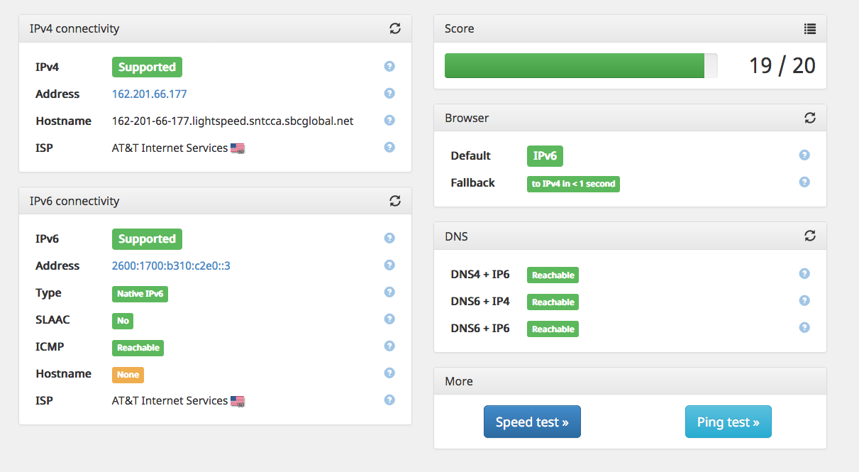

Trying to connect through Tor Ok!
Connecting through Tor to the acme challenge returned positive.
Recently AT&T changed my ipv6 address and I had to configure all the network with the new prefix.
The IntoDNS reporte seems fine for ipv4
https://intodns.com/bonsi.org
I checked with:
http://ipv6-test.com/validate.php
and it returned “web server is unreachable : Permission denied”
I am not blocking my ipv6 through firewalls
I can successfully ping
root# ping6 2600:1700:b310:c2e0::3
PING6(56=40+8+8 bytes) 2600:1700:b310:c2e0::3 --> 2600:1700:b310:c2e0::3
16 bytes from 2600:1700:b310:c2e0::3, icmp_seq=0 hlim=64 time=0.088 ms
16 bytes from 2600:1700:b310:c2e0::3, icmp_seq=1 hlim=64 time=0.172 ms
16 bytes from 2600:1700:b310:c2e0::3, icmp_seq=2 hlim=64 time=0.086 ms
16 bytes from 2600:1700:b310:c2e0::3, icmp_seq=3 hlim=64 time=0.175 ms
16 bytes from 2600:1700:b310:c2e0::3, icmp_seq=4 hlim=64 time=0.083 ms
but not able to connect directly to the server using the ipv6 https://[2600:1700:b310:c2e0::3]
Apache Server is working fine, I can reach all the domains from the regular internal browser.
It could be (Maybe) the AT&T router. Lately they updated the router and not sure how far they block things over. I only use the Server for Teaching purposes, none of the ips are assigned by ATT. The costs of assigned ip does not justify the means.
Any thoughts?

Unfortunately, I’m still seeing an inability to connect via IPv6 to any of the three IPv6 addresses listed in your DNS.
Thanks for testing @schoen ! I am able to ping all the ipv6 addresses from the server terminal.
The ipv6 addresses from the account have been changed recently by AT&T. I did my best to reconfigure but it seems to have some glitches happening somewhere in the network blocking the address.
