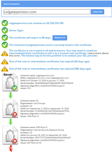

I am using Lets encrypt certificates for all non www domains and currently we are facing The Certificate is not trusted in all web browsers issue.
The non www domains SSL are working intermittently. Mostly failing for some regions with SSL error that your connection is not private.
If checked through SSL checker it shows root or intermediate certs has expired.
Please find the below screenshot for your reference

The webserver for that domain is sending a really strange certificate chain:
Certificate chain
 0 s:CN=colgatepension.com
   i:C=US, O=Let's Encrypt, CN=R13
   a:PKEY: rsaEncryption, 2048 (bit); sigalg: RSA-SHA256
   v:NotBefore: Oct 19 15:29:37 2025 GMT; NotAfter: Jan 17 15:29:36 2026 GMT
 1 s:C=US, O=Let's Encrypt, CN=R3
   i:C=US, O=Internet Security Research Group, CN=ISRG Root X1
   v:NotBefore: Sep  4 00:00:00 2020 GMT; NotAfter: Sep 15 16:00:00 2025 GMT
 2 s:C=US, O=Internet Security Research Group, CN=ISRG Root X1
   i:O=Digital Signature Trust Co., CN=DST Root CA X3
   a:PKEY: rsaEncryption, 4096 (bit); sigalg: RSA-SHA256
   v:NotBefore: Jan 20 19:14:03 2021 GMT; NotAfter: Sep 30 18:14:03 2024 GMT
Notice that the first certificate, the end leaf certificate with your hostname, was issued by "R13". However, the next certificate is "R3", which is an intermediate certificate already retired for some time now, and not the R13 which is to be expected. And the next intermediate is an ancient cross-signed root which has expired more than a year already.
Thus: something very strange is happening with your certificate chain.

This is the cross signed root, this chain is pretty old.
@amey that doesn't look like a fullchain.pem, it looks like a cert.pem cat a very old chain.pem
