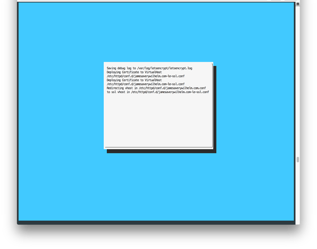

I successfully generated certificates, but Certbot couldn't create a proper SSL VHost for some reason.
So I manually created the jamesaverywilhelm.com-le-ssl.conf file and ran certbot-auto install with this result:
Deploying Certificate to VirtualHost
/etc/httpd/conf.d/jamesaverywilhelm.com-le-ssl.conf
Redirecting vhost in /etc/httpd/conf.d/jamesaverywilhelm.com.conf
to ssl vhost in /etc/httpd/conf.d/jamesaverywilhelm.com-le-ssl.conf
It seems everything should be in working order, but I'm not getting redirected to https and when I try to serve my site with https, I get the following error:
Your connection is not private
Attackers might be trying to steal your information from www.jamesaverywilhelm.com (for example, passwords, messages, or credit cards). NET::ERR_CERT_AUTHORITY_INVALID
It seems that the certificate that's being served is the self-signed cert attached to my VPS. I have no idea what I've done wrong. Any help would be greatly appreciated.

Also your screenshot says "Cannot find a cert or key directive in /files/etc/httpd/conf.d/jamesaverywilhelm.com-le-ssl.conf/IfModule/VirtualHost. VirtualHost was not modified.
I don’t know about httpd setup in CentOS but I’m guessing you need to add something similar to the above pointing to your certificate file and key file. And then restart Apache.

After creating that VHost config file, I reran certbot with the install subcommand, and got this message after:
I restarted Apache, but I'm still not redirecting to https and only serving the self-signed certificate from my VPS instead of the Let's Encrypt certificate. I have no idea what to try next.
