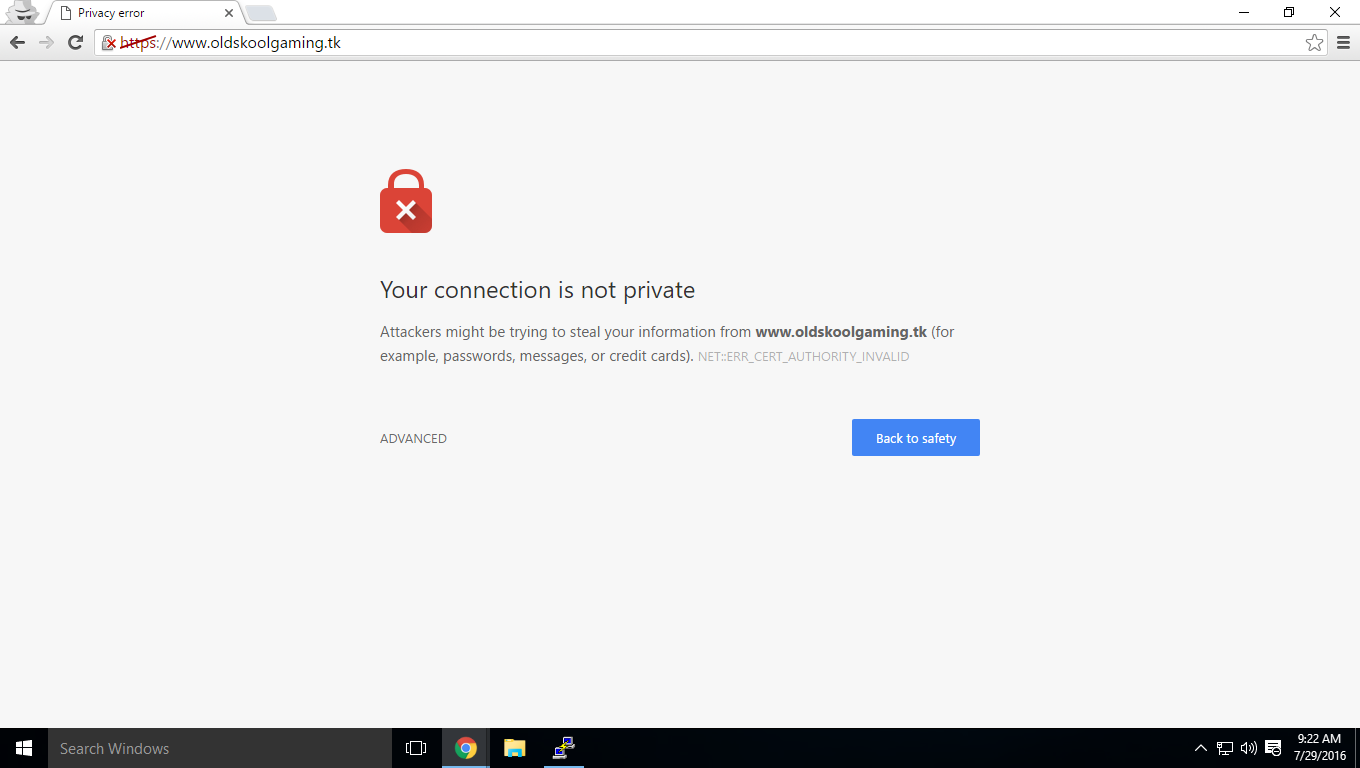

Then tried to visit https versions of both links… Boom !
Ummm., what’s wrong I’ve done this time ?! Duh !! :expressionless:

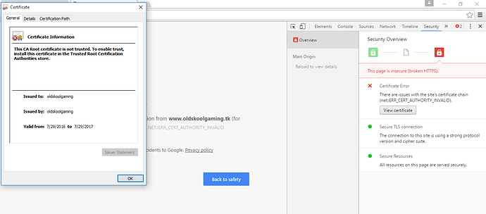

For some reason, the server isn’t using the correct certificate. It’s providing a self-signed certificate, not the one from Let’s Encrypt.
Which is strange, because the Apache plugin of certbot would reload Apache itself…

It looks like you’re setting a self-signed certificate somewhere in your config (this might have been generated automatically when you installed mod_ssl or something like that).
Try running grep -r "SSLCertificateFile" /etc/httpd and check if there are any certificate files you don’t recognize (i.e. that don’t belong to certbot), and get rid of those directives. If you need help with that, please post the entire file where you’ve found this directive.

/etc/httpd/conf.d/ssl.conf is the problematic file, /etc/pki/tls/certs/localhost.crt is the path to that self-signed certificate you’re seeing in the browser.

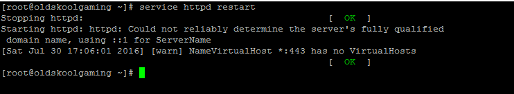

Okay So Change The Name Virtual host to 443, saved the file then executed
service httpd restart
Nothing happened ! Well for an healthy note.,
Here’s a message stating Server could not reliably determine it’s fully qualified domain., As much as I’ve experience in linux, this can’t be the problem, but maybe !
Your Turn…!
Let’s try removing all lines between (and including) <VirtualHost _default_:443> and </VirtualHost> in /etc/httpd/conf.d/ssl.conf. Not sure why apache is using that vhost to serve your domain, but it looks like that’s what’s happening.
