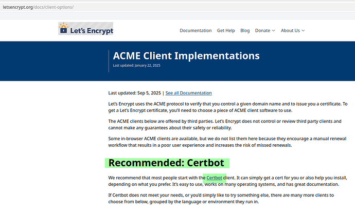

Do you happen to have a link to the official documentation on the current clients for Windows?
All I can find is this:
So, I am not sure how it is possible to find out that Certbot is neither current nor supported.
