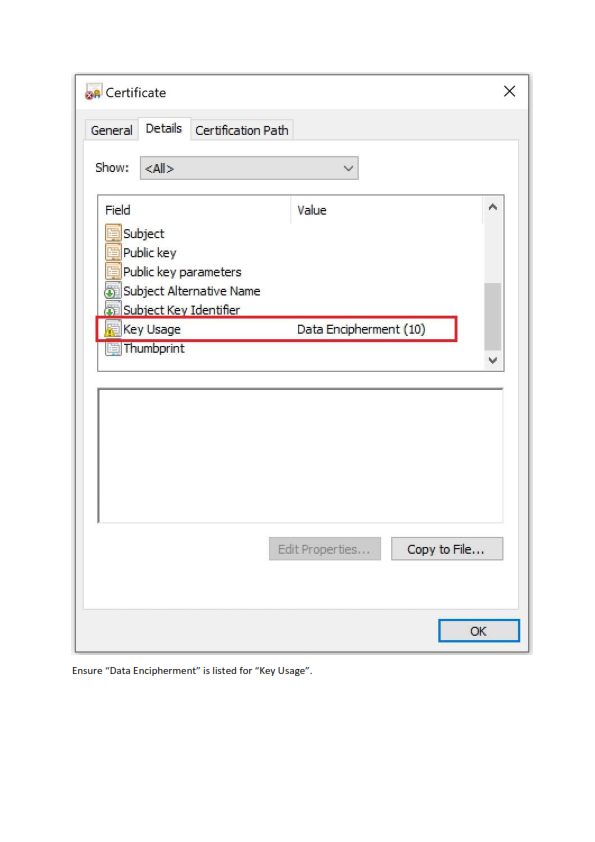

My domain is crowd-genie.com i have hosted it using the firebase. I need to integrate a third part plugin it said requriment is to have a SSL certificat with data encipherment i asked the firebase Support team for upgrade of the certificate to data encipherment but they couldn’t help me out.I need to know what is data encipherment and how to update my SSL certificate to it.

The Third party is SINGPASS it is a Singapore Government https://www.singpass.gov.sg/myinfo/intro.
They sent the Requriment as the above Screen Shot to have an SSL in the above formate
That’s usually only seen in custom application protocols. Let’s Encrypt only offers Key Encipherment certificates, but some other companies like Digicert do offer Data Encipherment certificates.

  • The image above shows ONLY data encipherment
  • The certificate transparency logs show BOTH DataEncipherment and KeyEncipherment on the singpass.gov.sg certificates
I have a feeling they want to ensure application data is encrypted with data encipherment for compliance, and are not directly concerned with https. Again, I could very well be wrong, but given the info I've seen... this makes some sense.

I don't think their concern for supporting Data Encipherment is in a TLS context. Their own site's keys have Key+Data and the https connection seemed to use Key; I think they require DataEncipherment for use in other contexts.
