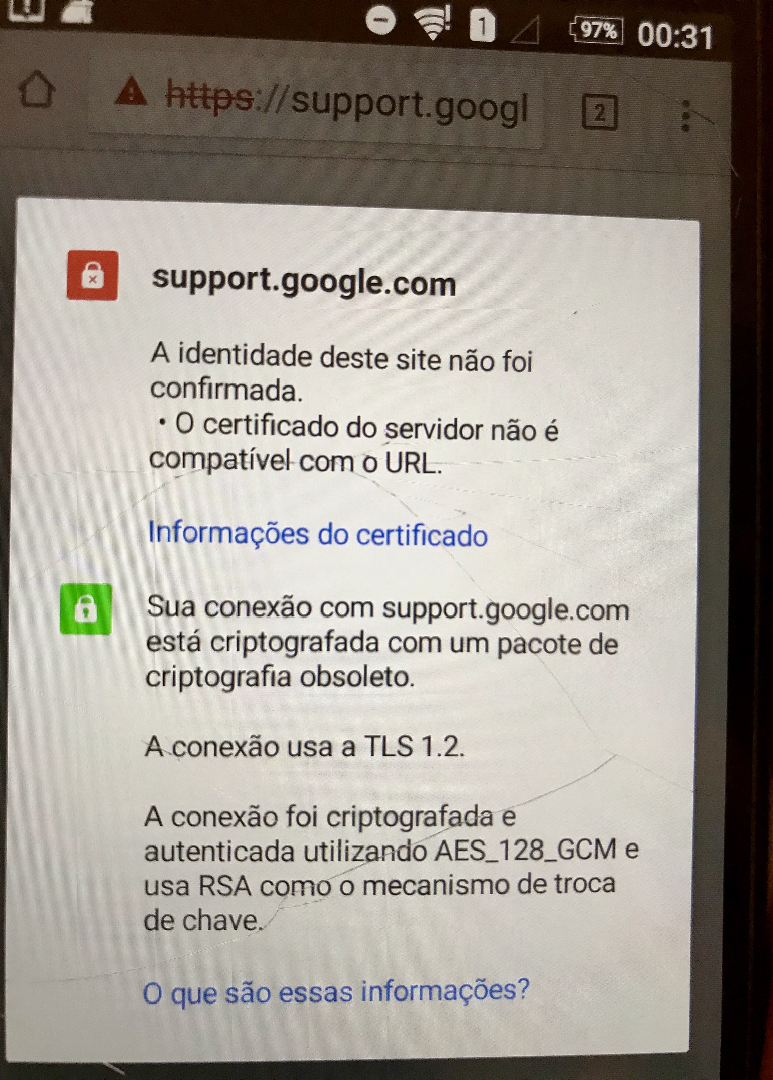

All compatibility issues with Mikrotik have been resolved but this one I will report is what harms everyone. In mikrotik hot spot with SSL works well with bypass, without displaying certificate security failure message with Apple IOS, Windows Phone and Android, however when opening the authentication screen on any android that default to CHROME, it appears the message fault message. If opened by the android browser does not inform the possible problem of “fraud” (man in the middle). Is there any solution to give bypass equally to all others smartphones?
Print problem for only open with chrome:
See https://support.google.com/chrome/answer/95617
So it appears the user is trying to visit some other website and they are getting your login screen instead. This is what a captive portal does! But your login screen isn’t that website, so the user gets a security error.
Most new Android devices pop a notification in the top bar that allows you to sign in to wireless captive portals without accidentally hitting the security screen. Many other platforms have something similar.
For older devices that do not have this feature, there is nothing you can do to stop this besides not having a captive portal. You’ll have this problem on any platform where a user tries to visit a HTTPS URL first and they don’t have or bypass the captive portal detection.
If you’re in a position to help people, just tell them to visit example.com first (the official test server of the Internet). This site is available over plain HTTP and thus won’t cause certificate errors.
Someone runs http://neverssl.com/ for this, too. (Unlike the official example domains there's no guarantee it will always exist, though.)
