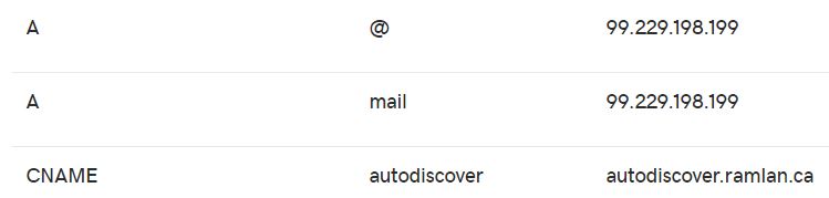

On GoDaddy - DNS entry are as follows:
A @ 99.229.198.199
A mail 99.229.198.199
CNAME autodiscover autodiscover.ramlan.ca
3
First, no, that record isn't present, at least not when I check it from here. Second, what makes you think that's an appropriate setting? You're setting autodiscover as an alias of itself. Just a moment's thought should tell you that's the wrong answer. Either set it with its own A record to the same IP, or set it as a CNAME to the root domain. Either is fine; I don't know that there's a particular reason to favor one over the other.
So for GoDaddy - I will change CNAME as follows:
A Autodiscover 99.229.198.199
That should work, and it's now showing up in public DNS.

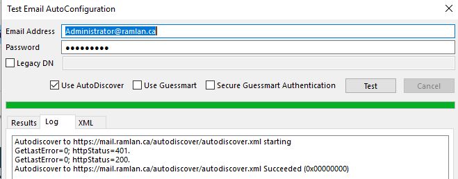

I tried the program again - still not working. Firewall is turned off - Yet having problem getting the cert.
1
Finally fixed all the issue and the certificate is issued successfully. Here is the SS
