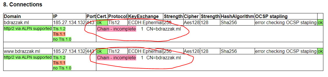

The certificate “chain” is incomplete. If you install the certificates you may be able to correct this (e.g. maybe you are using a file named cert.pem and the fullchain.pem file is what you need) or if your hosting service does everything they may need to improve their process so as to ensure the server sends a complete chain.
Some browsers can work around this (and so it works in your desktop Chrome and Edge) by guessing what should be in the chain, but not all of them.

that's wrong. @tialaramex has the correct answer, your chain is incomplete, that's not fixed.
See your check, some hours old, now rechecked to see if it is really fixed - https://check-your-website.server-daten.de/?q=bdrazzak.ml#connections
Two entries in the chain are required, not only one.
Using fullchain.pem should fix that, see the correct answer from @tialaramex
PS: That's a general problem with some older devices and the first call. So if you have the problem with Android 5.*, the working Android 10.* is completely unrelevant.

Note: using CA certificate chains
Most certificate vendors will ask you to install the CA chain certificates as well. These are not supported on InfinityFree and cannot be installed.
However, most browsers will recognize certificates from popular certificate issuers without a certificate chain as well, so you do not need the CA chain. Only certain outdated browsers may not properly recognize the certificates.
If you insist on using CA certificate chains, you could consider to [upgrade to premium hosting], where you can install your own certificates including their CA chains, as well as get fully automatic free SSL from Let's Encrypt.
