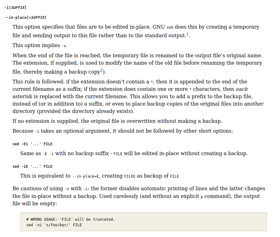

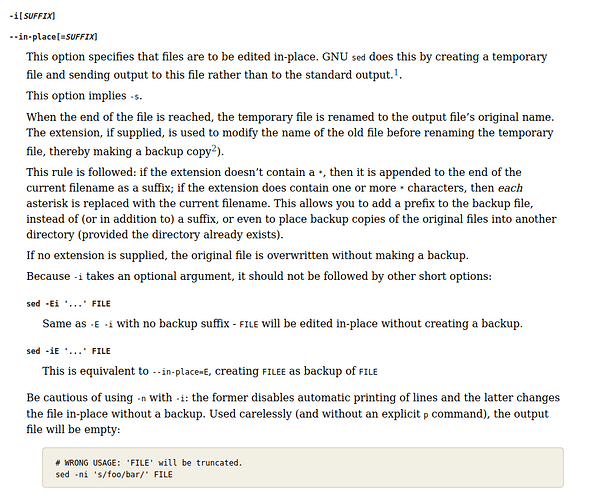

update all of these definitions.
you can use sed -i to do so.
https://www.gnu.org/software/sed/manual/sed.html#Command_002dLine-Options
