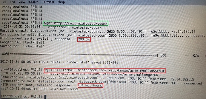

As I suspected, the OK file can’t be reached via IPv6:
But that is no consolation, as the IPv4 site also shows 404:
The OK file is just not being served by your system.
Try the standard “test.txt” file name instead.
