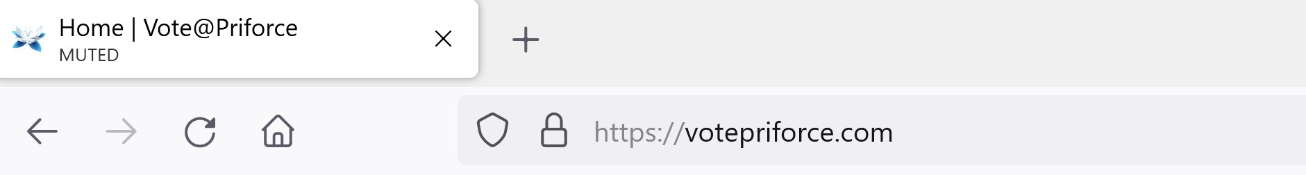

Below is my Firefox screen. Note the padlock and I saw your home page just fine. Are you able to upload a snapshot of the error you see? Or, just describe the error message? Maybe we are talking about two different problems.
This is the problem visitors are experiencing unfortunately. I will make a snapshot of the site and try it again under www. Thanks Mike for looking into this.
If you can even just describe the exact error message that would be helpful. There are many reasons why things "don't work". If there is not a big error message on the screen they may have to click the icon where the padlock should be to see the message.
