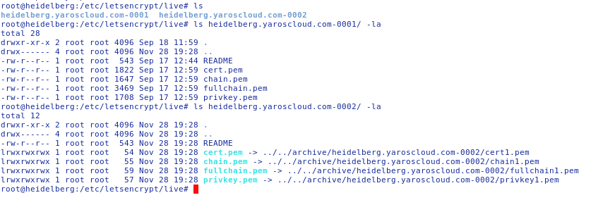

As for why your lineages are getting corrupted, did you make /etc/letsencrypt/renewal/heidelberg.yaroscloud.com.conf empty yourself? Can you include the output of sudo ls -al /etc/letsencrypt/live/heidelberg.yaroscloud.com-0001? The problem is hinted at in the above output where it says “expected /etc/letsencrypt/live/heidelberg.yaroscloud.com-0001/cert.pem to be a symlink”. Did you perhaps copy these files from somewhere else and lose the fact that it was a symlink rather than a file?
thank very much @bmw @schoen , this is my ls -la output
the simbol link stay now in /etc/letsencrypt/live/heidelberg.yaroscloud.com-0002/
And I used the certificates that saved in /etc/letsencrypt/live/heidelberg.yaroscloud.com-0002/
but then when I check it : “https://certificate.revocationcheck.com/heidelberg.yaroscloud.com” these yet expires in the same date that the other old certs.
