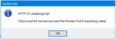

Thanks guys. It does provide this error message, but not sure it helps much:
HTTP-01 challenge fail
Check port 80 not blocked and the Router Port Forwarding setup

No, it doesn't help much. Those are two common examples of why it might fail but neither seems to match your situation. The RadioFeed support is probably best option.
Roughly what happens with an HTTP Challenge is your system prepares a unique "token" and requests a cert from the Let's Encrypt server. The LE server sends an HTTP request to your domain asking for this "token". There are (currently) 5 LE servers around the world that make the same request but never mind that for now.
Your system is not replying with the correct token value to the LE server(s). If you have logs to view inbound requests to your system that would help. Or, even the exact error the LE server sent to your system. The LE server does send a nice message but your system doesn't show it :frowning:
