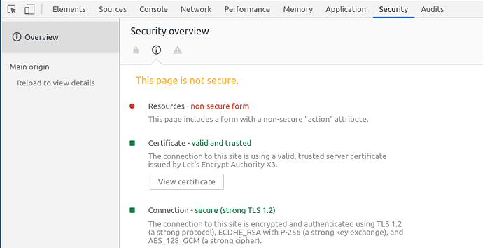

It’s interesting (and somewhat disturbing) that your post suggests that the reason for the lack of a green padlock in Chrome for co-operating.systems is that it’s using a Let’s Encrypt cert. This isn’t the case; Chrome gives the padlock for plenty of other sites with LE certs (including my own). The issue is rather one of mixed content. That seems like a pretty fundamental thing to get wrong.

The page I looked at in Google Chrome Version 68.0.3440.42 (Official Build) beta (64-bit) on OSX - and I think the latest stable Chrome was no different - is https://co-operating.systems/ . I just looked very carefully at the html from that page, and I can’t see any mixed content. All the local URLs are relative and I only have two URLs pointing out at another site.
Marking insecure for a mailto: URI in a form action is probably a bug (or at least a questionable decision by Chrome), but @danb35 is still right that Chrome does show the padlock for Let’s Encrypt DV certificate sites.
…but meanwhile, any number of other sites with Let’s Encrypt certs (including this one) show up with the green padlock. whynopadlock.com identifies the issue as being one of mixed content, specifically the form with a mailto: action. I can’t confirm that’s the reason (and Chrome itself isn’t very informative about what the issue is), but I guess it makes sense. In any event, it obviously is not the Let’s Encrypt cert.
Yep you are right! Who would have thought… I removed the form and I get the green padlock.
