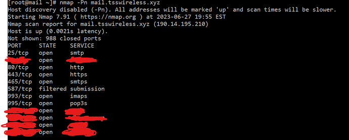

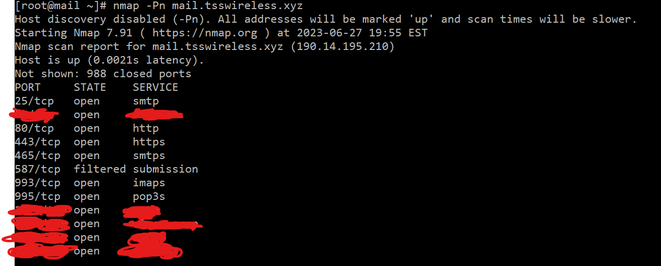

Hello everyone, I managed to solve the first error of could not reach acme-v02.api.letsencrypt.org/directory due to a wrong configuration of public networks in my router.
As for the ports, they are filtered because I only have a public IP and certain router services, apart from those used by my server, are exposed to the Internet.

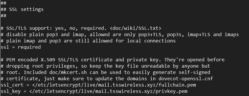

What does leave me in doubt that I have configured the letsencrypt certificates with my mail server but I don't know why the expired certificate appears on port 587, I don't know if this is any configuration; I currently use potfix + dovecot
If you copied the certificates from /etc/letsencrypt/live into some other location, you have to repeat that on every renewal, as the content of the certificate and key will change every time. You can script that with the --deploy-hook option.
