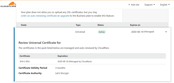

And the cert says it from 25.05.20. Why 25.05? I installed it today… Maybe it shows my previous instalation but it was on the VPS I deleted a week ago…

Maybe it's because of Cloudlfare? CF sees my OLD cert and IDK how to delete it :confused:
This looked weird.
It just looks like CloudFlare are issuing Universal Certificate from Let's Encrypt CA? (I thought they issue from Sectigo and DigiCert CA)
If this is the one, you don't need to worry about that.
This is managed automatically by CloudFlare and they'll renew it as needed. (If you delete it, visitors will never be able to view your website unless you move away from CloudFlare)
