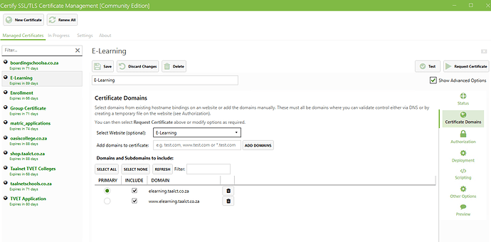

Thank you for the response, i’m checking my installation. I just managed to do a re-installation and i’m still having the same issue, i even deleted the certificate and started from scratch.
Below is a screenshot log showing the process taking place and then the platform i’m using to issue the certificates
That's not an installation, that's a certificate creation.
Your installation is wrong, so you have to check your IIS bindings.
Once again thanks very much, i managed to resolve the issue. I ended up restarting the whole ssl certificate process from scratch. So issuing the certificates per domain via Certify the Web was still giving me a problem. So decided to use one certificate for all the 7 domains i wanted to enable ssl for.
Below is a snap showing all is well now. And i again i appreciate the help.
