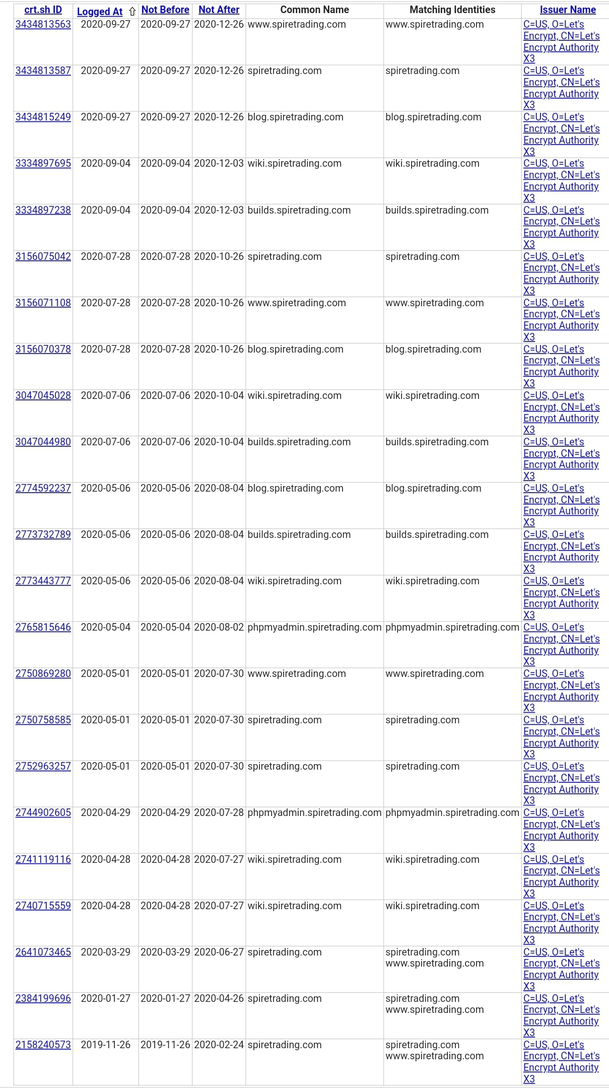

Complete Certificate History
https://crt.sh/?Identity=spiretrading.com&deduplicate=Y
All good, guys! I updated the certificate to cover for www and non-www as suggested and deleted the other one. Thanks both @Osiris and @griffin! You two saved my day.
