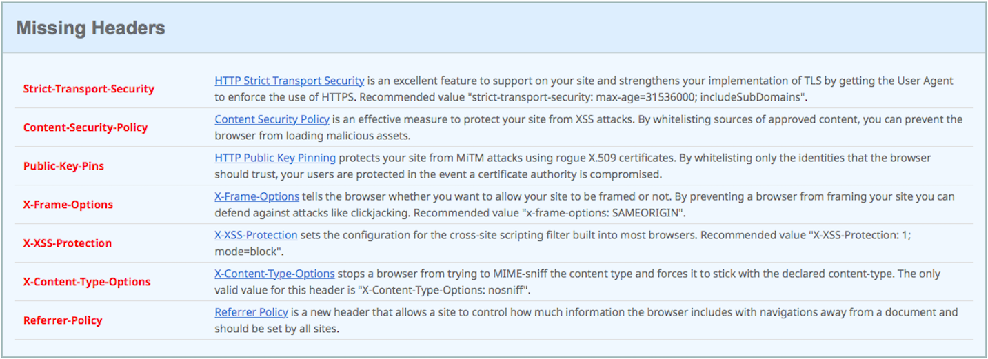

I just got the free SSL certificate from ‘Let’s Encrypt’ by way of my hosting company. I conducted some tests and I was given a wide range of ratings: from “F” to “A+”.
All this is completely new for me, but I would like to plug some holes in my security. For example, I understand that I should add HTTP Strict Transport Security header. Something like this:
Strict-Transport-Security: max-age=32000000; includeSubDomains; preload
But where? Should it be on the host server or within my website? Should it be a separate text file, a snippet within ‘.htaccess’ file, or a snippet in the header of my ‘index.php’ file? Somewhere else?

I have modified my .htaccess file according to your suggestions and with my host’s permission. Then, I tested my site on “observatory.mozilla.org”. My results improved from previous “F” (14/100) to “D” (35/100). :joy:
They recommend some more improvements, of which the most important ones are: the use of X-Frame-Options header and Content Security Policy’s frame-ancestors.
So, this will be my next move. I would surely appreciate it if you, guys, could help me with this.
