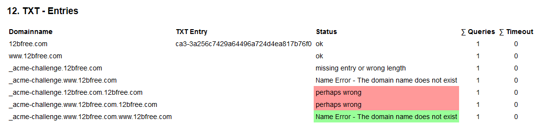

Just rechecked the domain using your site checker. -
Everything’s fine, except for point 12 "TXT Entries, where it says “perhaps wrong” for “_acme-challenge.12bfree.com.12bfree.com” and “_acme-challenge.www.12bfre
e.com.12bfree.com”
Could you comment on this, plz?
Read the complete output:
If a domain name doesn't exist, the dns server should answer with a Name Error = dns error 3.
The answer of _acme-challenge.www.12bfree.com.www.12bfree.com is correct, so it's green.
But checking the two other (wrong) names, there is no "Name error", instead, there is an answer.
So the server says: "This name exists, but there is no TXT entry". But I don't think these entries are defined.
-->> curious name server answer.

Are you suggesting I add a DNS TXT entry for 12bfree.com at Cloudflare?
I agree it’s a ‘curious name server answer’ because ‘12bfree.com’ exists as an ‘A’ record in DNS. ‘www’ and various subdomains are CNAME entries. Nothing wrong with that, right?
If I’m not mistaken a TXT record is for additional ownership validation. Do I really need that for a certificate update? The way I understand it DNS sec identifies ownership realiably. Why then a TXT record?
Again: Do you recommend adding a TXT entry then?
You are understanding something completely wrong. A txt record is a txt record, nothing else. It may used as an ownership validation, it may used as a joke or a simple test: "This is a small txt text entry".
So your question
Looks like you mix things that are completely different.
If you want to create a certificate, you may use dns validation. So read
But then a txt entry with the domain name 12bfree.com isn't relevant, because _acme-challenge as first part is required.
