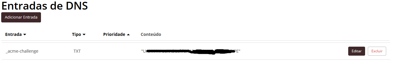

So. I had insert the dns TXT entry in all 3 domain (vide image)

obs.: If i run the commands again, will not (like you predicted) fit my needs. This panel in screenshot is the only way i could made DNS Entry changes. And do not spread fast enough the changes.
