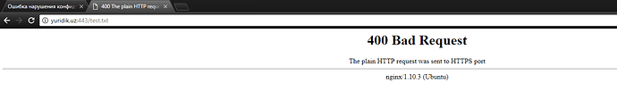

http://yuridik.uz/test.txt
https://yuridik.uz/test.txt
http://yuridik.uz:443/test.txt
https://yuridik.uz:80/test.txt
you too could not try???
that name works in both http and https :slight_smile:
