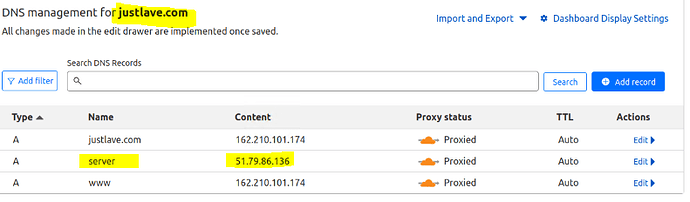

Where is the DNS section. You'll find one of those is proxied and the other is not
Please see the Cloudflare docs

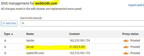

Yes, it says "PROXIED".
Check your other domain it won't say that

That said, oddly the one that "works" is the one that should be proxied but is not.

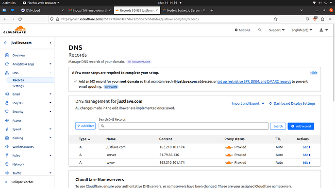

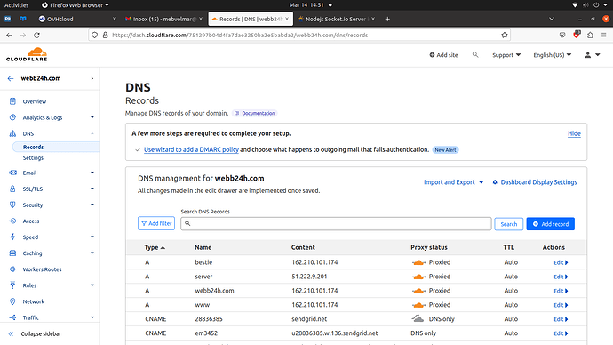

No, I get that. What is odd is that the Cloudflare DNS panel says it is proxied but it is not. So, it works because it does not use the CDN.

Turn off "Proxied" status. Your working domain isn't using it even though it is configured as such.
Yes, the Cloudflare settings are ODD.

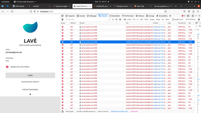

Mike, our company will certainly donate to letsencrypt but it's a false alarm. If you visit justlave.com/app and open the console, yes I'm able to poll https://server.justlave.com:3008/socket.io/?EIO=4&transport=polling&t=ORXlzcC and access the socket https://server.justlave.com:3008/socket.io/socket.io.js?_=1678824065831 but now all the GET are blocked! Still not able to connect to the server.
It's polling just fine here.
Maybe check the console for the reason why it's not working for you. But I doubt it has anything to do with something that's within the scope of this Community.
