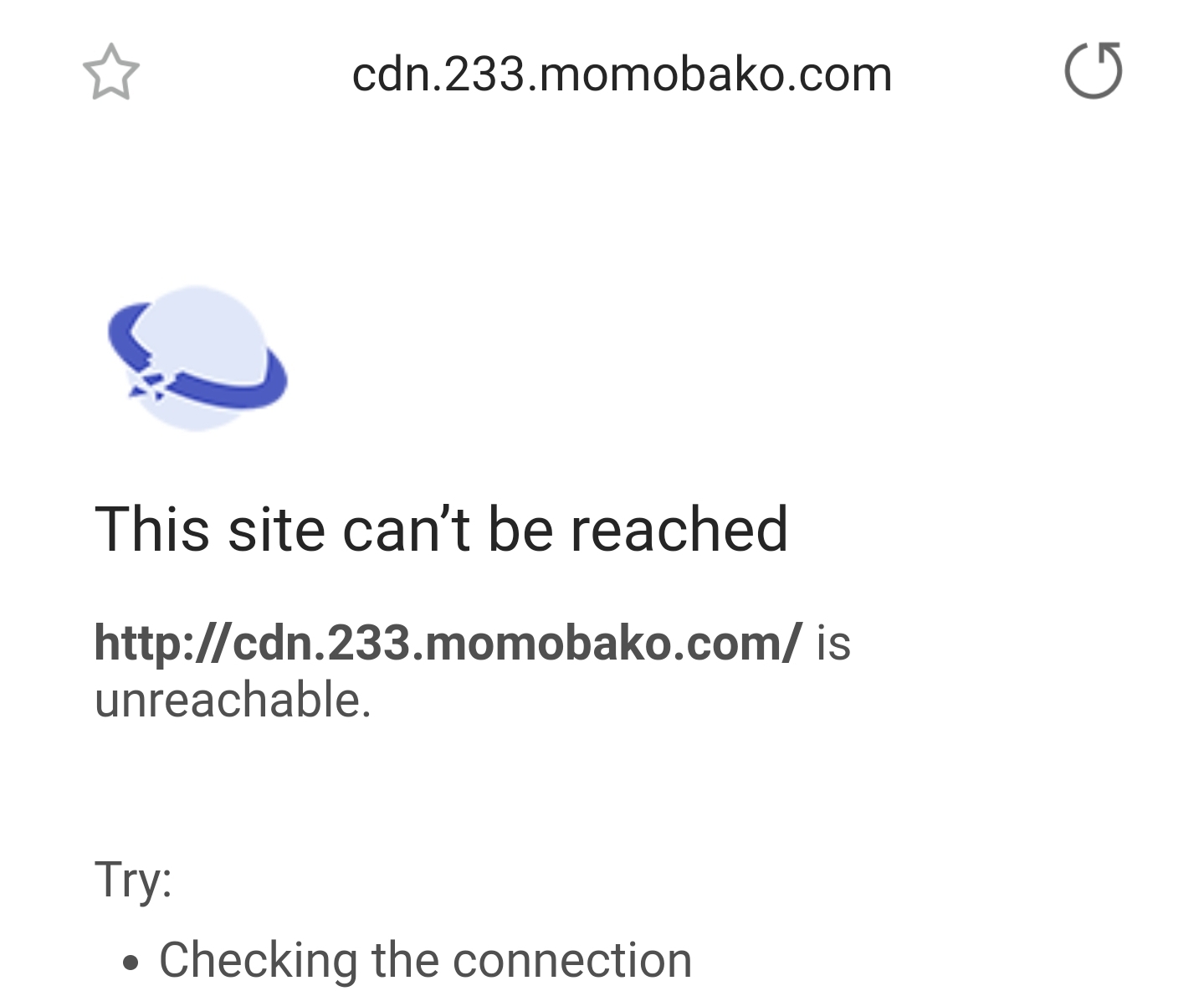

This web page isn't online yet, and the temp server set up by certbot is closed, and the _acme-challenge dns record I manually added is deleted by me, but I'm sure both my PC and some dns lookup services online can read that record before. The problem is the domain cant be resolved be letsencrypt.
