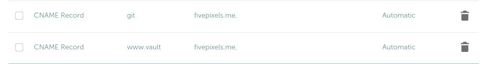

I added these two records:
And it looks like it may be working now. I think it took some time for the DNS to update becuase I was getting the same error for a little bit longer. The lack of A/AAA records error went away, but I'm now authorization limited for the next hour or so.
I'll update once I know if this fixes this.
www.git is still missing.
Actually I have it added - I wasn't keeping track of how many I added, I just guesstimated.

Looking back now, I set the records to CNAMEs rather than A/AAAA - do they need to be A records? When I provide a A record, it asks for the target to be an IP - which I would need to set to the same as my A record for the first record in the last screenshot right?
