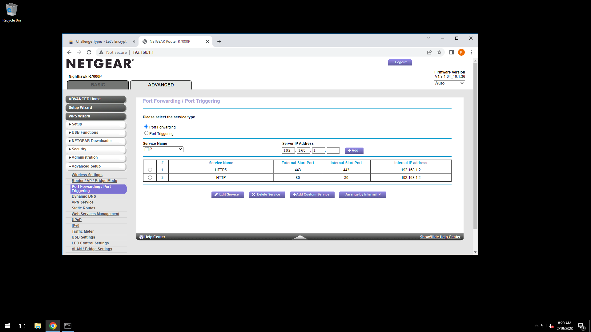

Is there also a second router?
[provided by the ISP]
LOL.... Looks like IIS is working and live so port 80 should be open now.
I tried running "certbot certonly --standalone" and still getting challenge errors.
The comcast router is in bridge mode. I'll recheck though

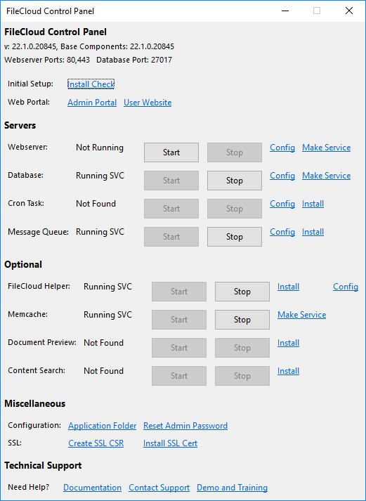

I was able to get a cert but following installation from within filecloud, Since then Apache service won't start.
The error log shows the following.
[Thu Mar 16 20:44:21.306611 2023] [mpm_winnt:notice] [pid 2200:tid 388] AH00422: Parent: Received shutdown signal -- Shutting down the server.
[Thu Mar 16 20:44:23.308772 2023] [mpm_winnt:notice] [pid 3704:tid 416] AH00364: Child: All worker threads have exited.
[Thu Mar 16 20:44:24.199859 2023] [mpm_winnt:notice] [pid 2200:tid 388] AH00430: Parent: Child process 3704 exited successfully.
[Thu Mar 16 21:15:13.787257 2023] [ssl:emerg] [pid 8340:tid 384] AH02565: Certificate and private key www.example.com:443:0 from C:/xampp/apache/conf/ssl.crt/server.crt and C:/xampp/apache/conf/ssl.key/server.key do not match
AH00016: Configuration Failed
[Thu Mar 16 21:15:34.078355 2023] [ssl:emerg] [pid 9648:tid 384] AH02565: Certificate and private key www.example.com:443:0 from C:/xampp/apache/conf/ssl.crt/server.crt and C:/xampp/apache/conf/ssl.key/server.key do not match
[Thu Mar 16 21:17:44.451006 2023] [ssl:emerg] [pid 2432:tid 108] AH02565: Certificate and private key www.example.com:443:0 from C:/xampp/apache/conf/ssl.crt/server.crt and C:/xampp/apache/conf/ssl.key/server.key do not match
[Thu Mar 16 21:42:59.425232 2023] [ssl:emerg] [pid 5576:tid 364] AH02565: Certificate and private key www.example.com:443:0 from C:/xampp/apache/conf/ssl.crt/server.crt and C:/xampp/apache/conf/ssl.key/server.key do not match
[Thu Mar 16 21:44:39.425076 2023] [ssl:emerg] [pid 5804:tid 348] AH02565: Certificate and private key www.example.com:443:0 from C:/xampp/apache/conf/ssl.crt/server.crt and C:/xampp/apache/conf/ssl.key/server.key do not match
[Thu Mar 16 22:06:06.834911 2023] [ssl:emerg] [pid 3112:tid 388] AH02565: Certificate and private key www.example.com:443:0 from C:/xampp/apache/conf/ssl.crt/server.crt and C:/xampp/apache/conf/ssl.key/server.key do not match
The error explains the problem well. That server.crt and server.key file are not a valid cert and private key. I see you got a Let's Encrypt cert today but how did these files in the /xampp/apache/... folder get created?
Well, that panel didn't use your new Let's Encrypt certs. I don't know Filecloud. It does not come up often in this forum but maybe someone else will know.
