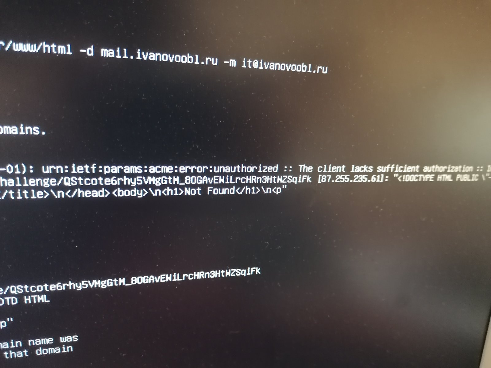

Tried from another server, it gives an authorization error, we can not understand why

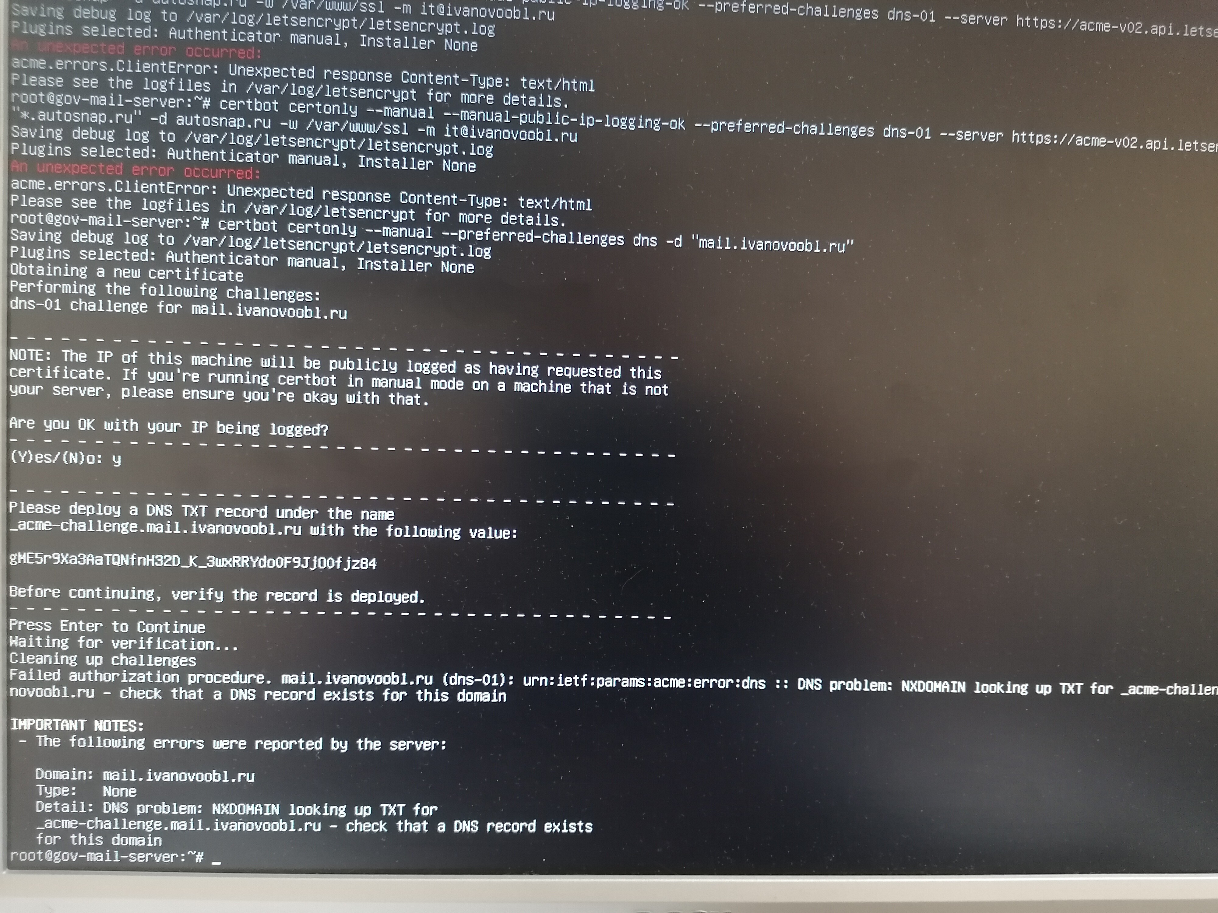

Try this instead:
sudo certbot certonly --manual -preferred-challenges dns -d "mail.ivanovoobl.ru"
Be sure to follow the instructions onscreen that will direct you to add a TXT record to your DNS zone for _acme-challenge.mail.ivanovoobl.ru with the large, random value string given to you by certbot.
Did not work
