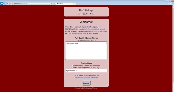

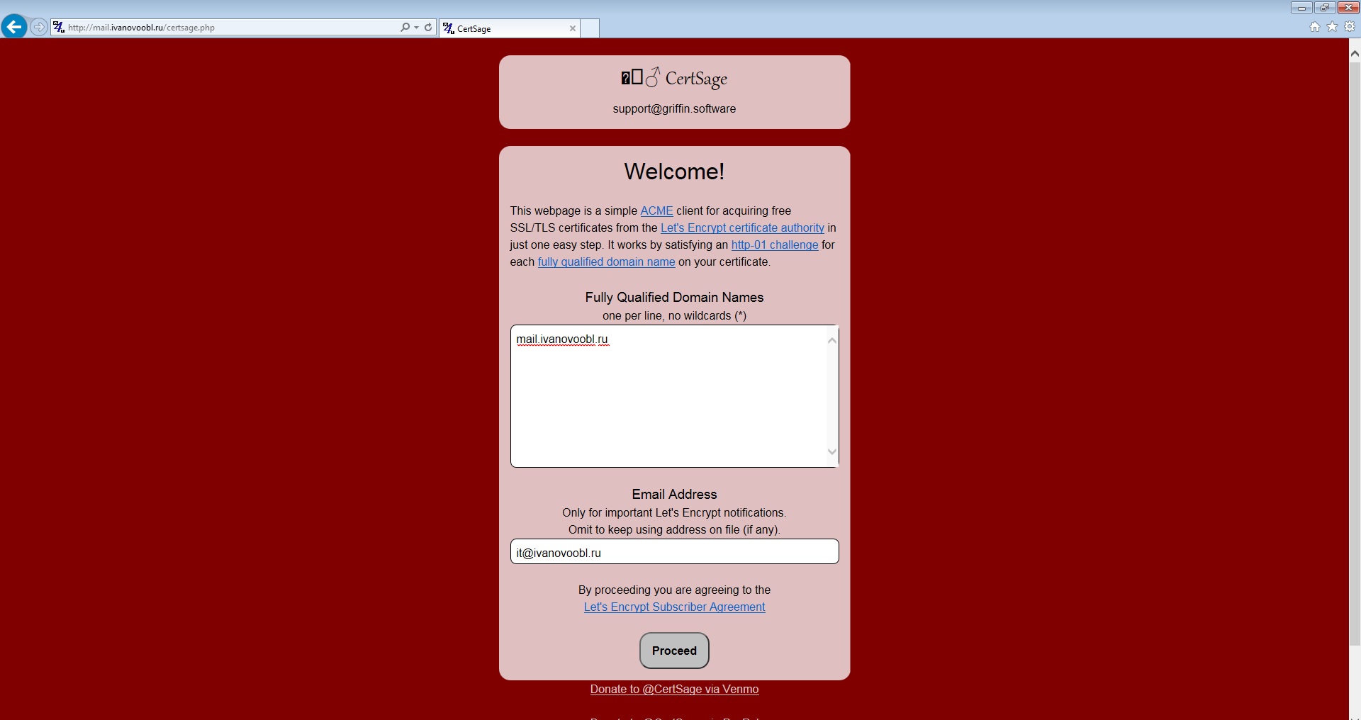

Good afternoon, I decided to try through another browser to go on the link, it went, after entered the data and pressed the button gets out 500 errors, what could it mean?
The 500 errors are usually the result of the PHP version being too old. When I try to access http://mail.ivanovoobl.ru/certsage.php, I still get 403 Forbidden. Is there an error log file in the directory with certsage.php?
tell me how the log file should be called?
Depends on your PHP. Usually something like error_log.txt or errorlog.txt.
I looked at the root where certsage.php and there are no similar files anywhere in the folders nearby

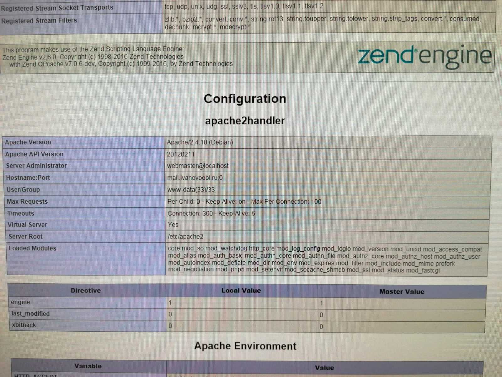

Download this file:
phpinfo.txt (19 Bytes)
Put it in the same folder as certsage.php then change its file extension from txt to php.
Visit http://mail.ivanovoobl.ru/phpinfo.php then take a screenshot. Be sure the screenshot includes the PHP version. You might need several screenshots to capture everything.

What version is currently shown when you visit phpinfo.php?
the version is the same because it was not possible to update
