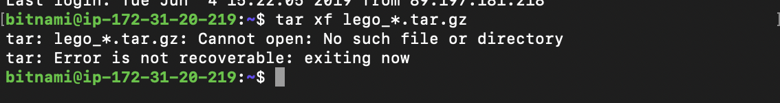

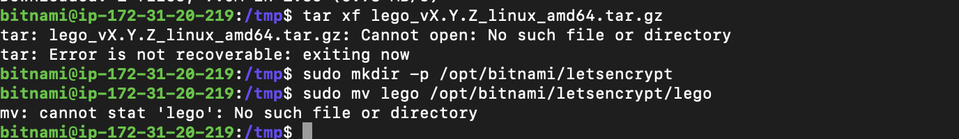

In your tar xf command you left the “X.Y.Z” in the filename. That needs to be replaced with the version number you downloaded, or you could use a shell wildcard:
Run tar xf lego_*.tar.gz and then the sudo mv lego /opt/bitnami/letsencrypt/lego command should work.
Hi @titchen, did you run that command in the same directory you downloaded the lego archive? It looks like the answer may be no because no files matched the wildcard.
You should be able to run these commands without error exactly as written. After that you can continue with “Step 2” of the Alternative Approach instructions.
If you’re curious, I slightly modified the wget used in the curl command line to specifically output to lego.tar.gz (by adding -O lego.tar.gz) so we can ignore the version and simply tar xf lego.tar.gz.

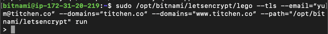

It looks to me like you used "smart quotes" in your command and the shell is waiting for more input. You need to use regular quotation marks and not the smart quote characters. Try typing them instead of copy/pasting into your terminal.
I think that should have been -email yum@titchen.co and a space was replaced by a -.

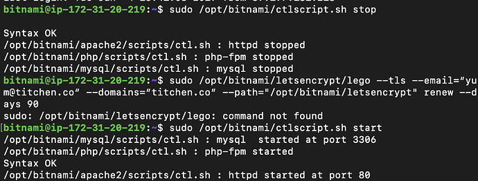

The second error I can see was when you were creating the symlinks from the issued certificates to the location your webserver config tries to load them from.
and DOMAIN was supposed to be replaced by your real domain name.
I bet those symlinks are now broken and that's why Apache won't start saying:
'/opt/bitnami/apache2/conf/server.crt` does not exist or is empty.
You'll want to go back in the process to fix the lego command you ran. Make sure you don't move on to the next step of the instructions until each command completes without an error.
After you fix the lego command you should change your sudo ln -sf commands to make sure they use your real domain name and not the placeholder "DOMAIN".
