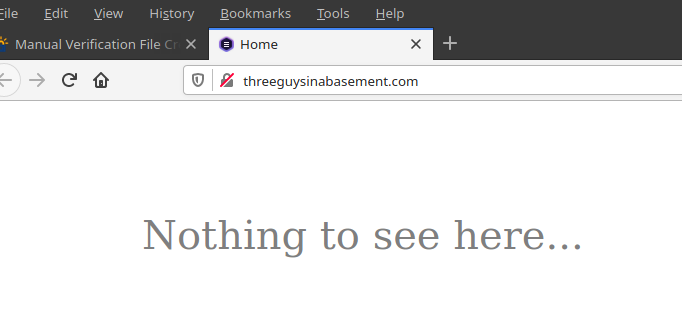

Huh. That's.... strange. It should just be showing a white page with "Nothing to see here," written on it and did when I started this thread. I'm actually quite confused as to what that is all about (the zone5hosting bit specifically). Nowhere that I can see has a redirect set up, let alone for anything remotely like that. Unless deleting the expired certificate did something to open that up, but I would anticipate that would just give me a warning about privacy or invalid certificates. There is literally nothing on this domain right now except for a placeholder page so that's a bit of investigative work I need to figure out now...
Screenshot_2020-06-26_11-44-55
From my vantage just now on the Oregon coast. (for reference)
Rip
Awesome. I don't know what was going on, but I removed files from the directory and reuploaded the basic files that were there. I'm glad that it's working for someone other than myself.
I suspect that I had a garbage file in there from who knows when and for what purpose that was causing the zone5hosting thing.
Waaaaaaiiiitttt a minute…
I just remembered that my host did something to the server the other day that had downtime. I don’t know if they were upgrading Apache or not. I’m going to reach out to them and see if there’s something that changed on their end that is causing this and report back.
