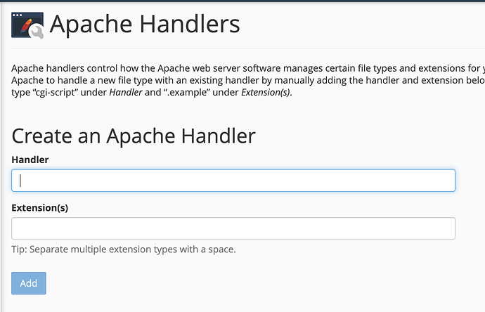

How do you config Apache to allow .well-known/acme-challenge? Could that be causing the error?

I'm a bit confused why an nginx server is listening for http (on port 80) and an apache server is listening for https (on port 443). I don't see how an Apache .htaccess file would be able to cause a redirect in those circumstances. No matter though because .htaccess files should be avoided whenever possible anyhow.
The challenge you will face is that certbot will create an exception in the port 80 webserver configuration when either the nginx or apache authenticator is used to satisfy an http-01 challenge, which prevents the http to https redirection from occurring for the challenge. Once the certificate is successfully acquired, it must then be installed into the port 443 webserver configuration. So, nginx will satisfy the challenge and apache will use the certificate. It would also be possible to use the webroot authenticator instead with a bit more information.
