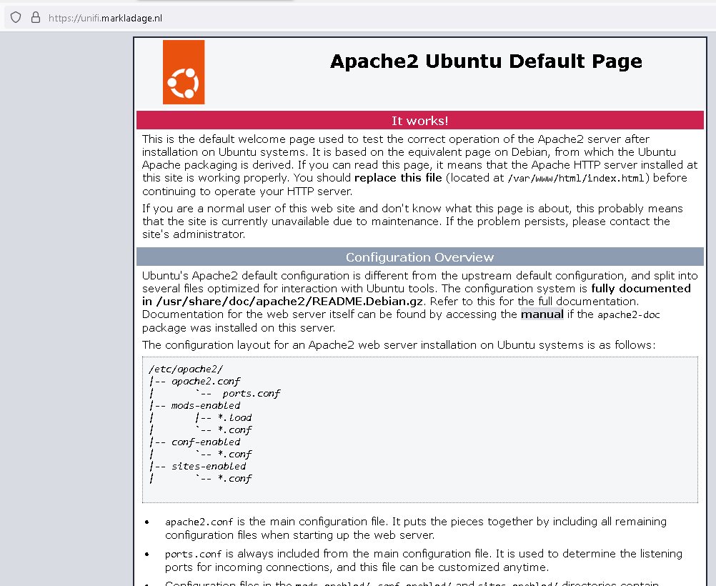

This is what I see with Firefox
And its certificate seems fine:
Maybe I don't quite understand what happened. I also think the certificate is good, but when I want to reach my UniFi controller via https://unifi.markladage.nl:8443/ I get a privacy error.
Whatever is listening on port 8443 is using a self-signed Unifi cert. Your Apache server listening on port 443 (https) uses the Let's Encrypt cert (as Bruce showed).
