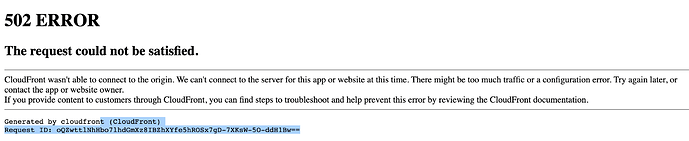

Following this guide to a tee creates the xxx.cloudfront.net distribution, which interacts with the Lightsail installation with a HTTP origin policy.
When switching the origin policy to HTTPS, a 502 error presents itself.

  • When setting the origin policy to be HTTPS only on the Lightsail side results in the following error:

I just tried removing the host header forward and setting the HTTPS origin and it came up with the same 502 error.
