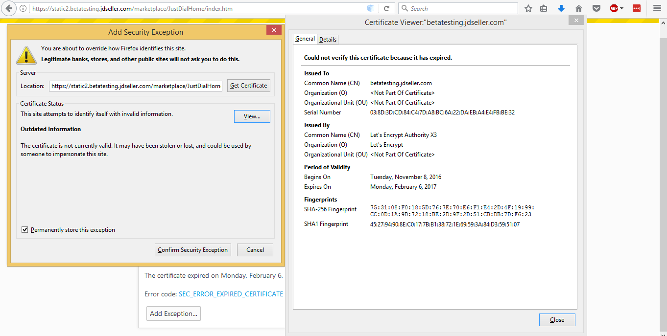

I’ve recently renewed my existing certificate. Post renewal I copied the certificate directory onto haproxy and reloaded haproxy but post reload mysql website is sometimes showing unsecure and at times secure

so sometimes it throws certificate expired randomly for any of the above domains and subdomains and at times loads https properly.
My certificate is on haproxy and my nginx is on another server.
This was working fine earlier but Post Latest renewal I’m facing this problem.

You appear to be using 2 different certs in your config. One is showing
Issuer: C=US, O=Let's Encrypt, CN=Let's Encrypt Authority X3
Not Before: Feb 8 16:33:00 2017 GMT
Not After : May 9 16:33:00 2017 GMT
The other is the old cert
Not Before: Nov 8 04:44:00 2016 GMT
Not After : Feb 6 04:44:00 2017 GMT
I'd suggest a quick check of your configs and make sure all of them are pointing to the "live" certificates and not the "achive" ones.
Thanks for your prompt reply. However, my configuration is fine. I’ve double checked it.
I have renewed the certificate on server A (a few days back) and then copied the entire directory (ignoring the symlinks to …/…/archive/betatesting.jdseller.com on the same server) using “/etc/letsencrypt/live/betatesting.jdseller.com” to server B to “/etc/haproxy/certs” and then restart haproxy on server A and nginx and php on server B. Hope I’m doing things properly here.
Please suggest…

Your default certificate on IP 125.18.61.66 is still the old certificate
Certificate:
Subject: CN=betatesting.jdseller.com
if you check your config I'm sure it's still pointing to the old certificate.

Yes, the problem is not with the generation of the cert though - it is that you are still using an old cert somewhere.
I’d suggest checking the actual content of the cert files.

as you can see your HA/WebServers are still serving the old certificates
there is an article on how to to do this here: https://www.digitalocean.com/community/tutorials/how-to-secure-haproxy-with-let-s-encrypt-on-ubuntu-14-04
Andrei
When terminating SSL on HAProxy, ensure that:
a) You have combined the key, domain certificate and intermediate in the right order in the pem file for HAproxy
b) You are referencing the correct (and updated) pem file in HAProxy configuration
See this gist as a reference for example (“Create Requried PEM for HAProxy” and “Configure HAProxy to use this new PEM” sections).
