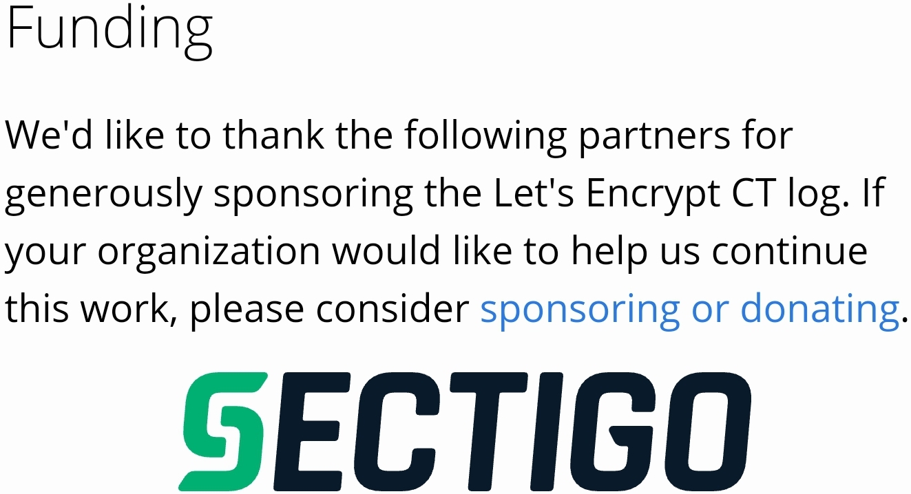

That's true. I mean it is a free tool and I guarantee this site already contains at least a million links to crt.sh. It's mentioned in our #help template. Wonder if Let's Encrypt would be interested in their own CT log? :thinking:
Does one of the Let's Encrypt sponsors offer a CT log?
Like I said, I'm not against the site. I use it too on this Community. But I think this Community (with external, non-LE-affiliated users) is a different story than putting it on your official website, which might have more "statement" to it.
They run multiple CT logs. Just not a CT log aggregator :stuck_out_tongue:
You did see this, right... :wink:
Nope, I did not.. :scream: :cold_face: :sweat_smile:
