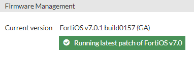

In my cases, I'm using 7.0.1 and have no problem getting certs.

Sorry, you are correct [I was thinking about FortiOS]
FortiWEB 6.4.1 should be out within a week (or so).
