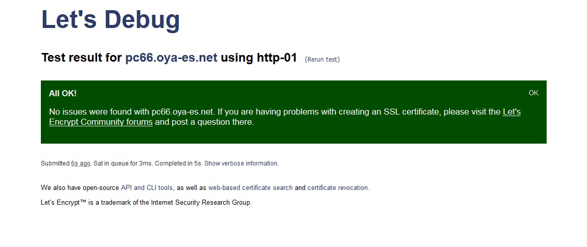

its appear all okey, but when we did the command, http-01 challenged failed.

If you use only renew, all domain names are validated. Have all domains the same ip address?
Your main configuration looks ok:
• http://pc66.oya-es.net/
212.51.58.50 200 0.183 H
• https://pc66.oya-es.net/
212.51.58.50 200 0.933 N
Certificate error: RemoteCertificateChainErrors
• http://pc66.oya-es.net/.well-known/acme-challenge/check-your-website-dot-server-daten-dot-de
212.51.58.50 404 0.200 A
Not Found
Port 80 is open and answers correct. So if you need only a certificate with that domain name, find your DocumentRoot and use that.
certbot run -a webroot -i apache -w yourDocumentRoot -d pc66.oya-es.net
If you need one certificate with all domain names, perhaps you need more then one -w parameter.
