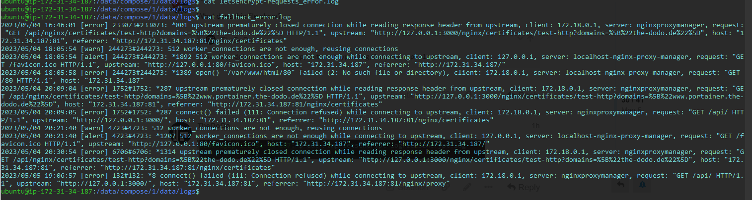

actually this is the log from the files here so proxhost 2
ubuntu@ip-172-31-34-187:/data/compose/1/data/logs$ cat proxy-host-2_error.log
2023/05/03 19:30:03 [error] 4451#4451: *155 portainer could not be resolved (2: Server failure), client: 172.18.0.1, server: portainer.the-dodo.de, request: "GET / HTTP/1.1", host: "portainer.the-dodo.de"
2023/05/03 19:38:49 [error] 5572#5572: *205 portainer could not be resolved (2: Server failure), client: 172.18.0.1, server: portainer.the-dodo.de, request: "GET / HTTP/1.1", host: "portainer.the-dodo.de"
2023/05/04 12:59:05 [error] 183198#183198: *403 portainer could not be resolved (2: Server failure), client: 172.18.0.1, server: portainer.the-dodo.de, request: "GET / HTTP/1.1", host: "portainer.the-dodo.de", referrer: "http://172.31.34.187:81/"
2023/05/04 12:59:05 [error] 183198#183198: *403 portainer could not be resolved (2: Server failure), client: 172.18.0.1, server: portainer.the-dodo.de, request: "GET /favicon.ico HTTP/1.1", host: "portainer.the-dodo.de", referrer: "http://portainer.the-dodo.de/"
2023/05/04 15:51:12 [error] 217730#217730: *560 portainer could not be resolved (2: Server failure), client: 172.18.0.1, server: portainer.the-dodo.de, request: "GET / HTTP/1.1", host: "portainer.the-dodo.de"
2023/05/04 16:31:15 [error] 226269#226269: *698 portainer could not be resolved (2: Server failure), client: 172.18.0.1, server: portainer.the-dodo.de, request: "GET / HTTP/1.1", host: "portainer.the-dodo.de"
2023/05/04 16:33:56 [error] 226269#226269: *717 portainer could not be resolved (2: Server failure), client: 172.18.0.1, server: portainer.the-dodo.de, request: "GET / HTTP/1.1", host: "portainer.the-dodo.de", referrer: "http://172.31.34.187:81/"
2023/05/04 16:34:09 [error] 226269#226269: *718 portainer could not be resolved (2: Server failure), client: 172.18.0.1, server: portainer.the-dodo.de, request: "GET / HTTP/1.1", host: "portainer.the-dodo.de", referrer: "http://172.31.34.187:81/"
2023/05/04 16:34:10 [error] 231277#231277: *723 portainer could not be resolved (2: Server failure), client: 172.18.0.1, server: portainer.the-dodo.de, request: "GET / HTTP/1.1", host: "portainer.the-dodo.de", referrer: "http://172.31.34.187:81/"
2023/05/04 16:34:11 [error] 231277#231277: *723 portainer could not be resolved (2: Server failure), client: 172.18.0.1, server: portainer.the-dodo.de, request: "GET / HTTP/1.1", host: "portainer.the-dodo.de", referrer: "http://172.31.34.187:81/"
2023/05/04 16:34:17 [error] 231277#231277: *723 portainer could not be resolved (2: Server failure), client: 172.18.0.1, server: portainer.the-dodo.de, request: "GET / HTTP/1.1", host: "portainer.the-dodo.de", referrer: "http://172.31.34.187:81/"
