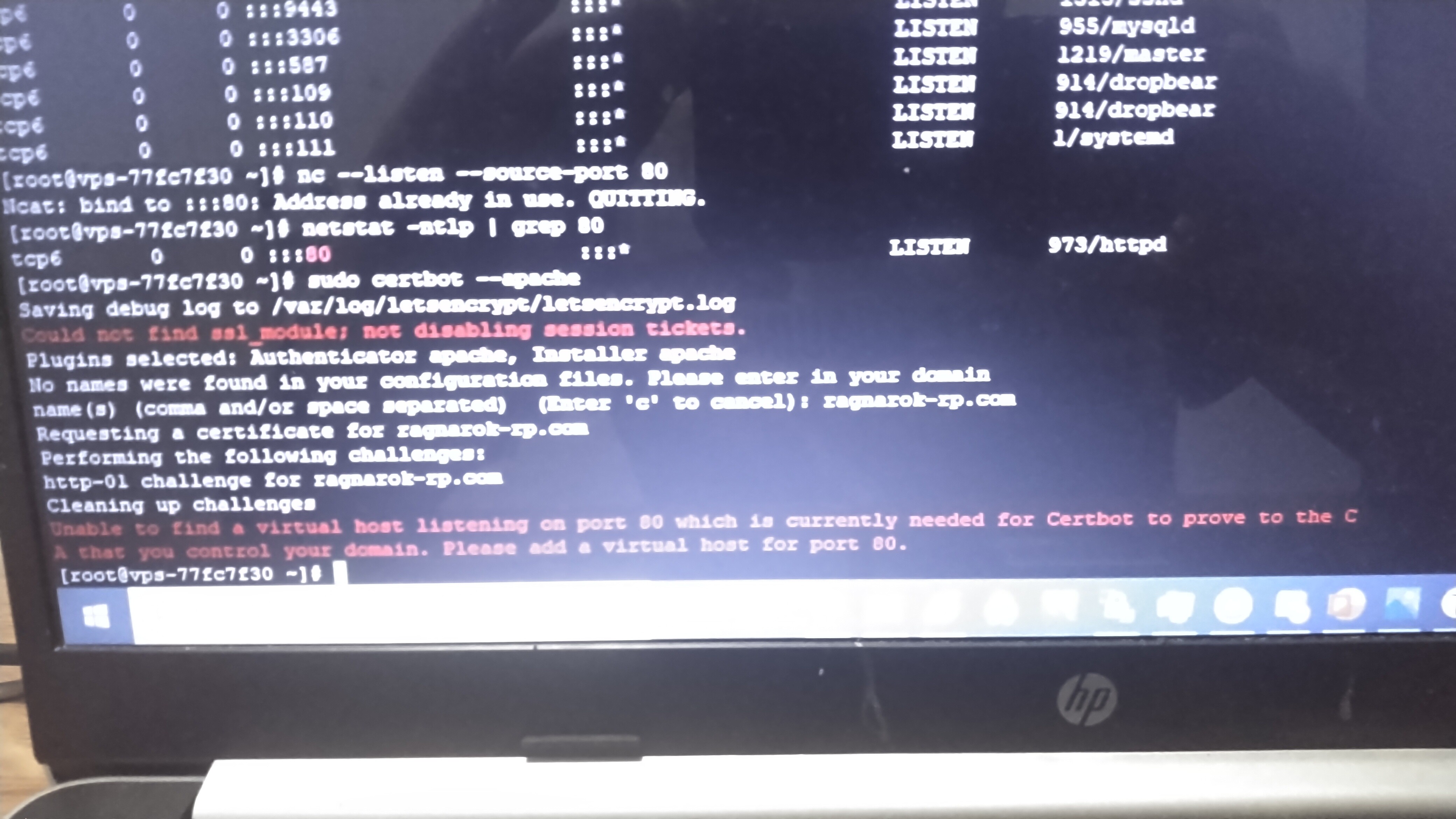

I ran this command: sudo certbot --apache
The operating system my web server runs on is (include version): Centos8
My hosting provider, if applicable, is: OVH
I'm using a control panel to manage my site (no, or provide the name and version of the control panel):No
The version of my client is (e.g. output of certbot --version or certbot-auto --version if you're using Certbot): lastest install
When I attempt to run the above command I get the attached error. I have no issues on the debug.
You can see I confirmed the port is listening.
Hi @Minuvas
please read your output, there is your complete answer.
Please add a virtual host for port 80
The documentation of your system has samples.

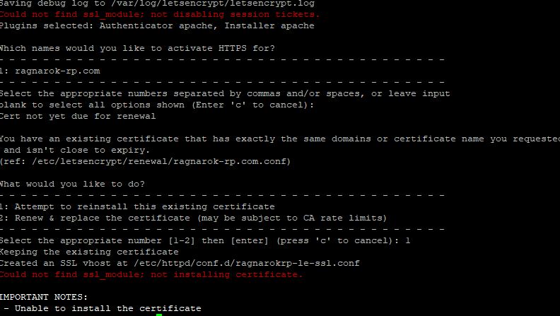

Hello @Minuvas,
You should install mod_ssl. I don't use CentOS but:
yum install mod_ssl
or
dnf install mod_ssl
should solve the "problem".

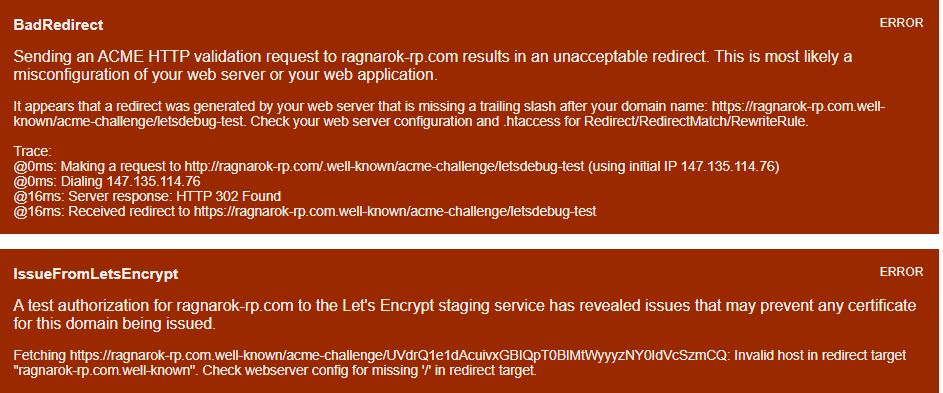

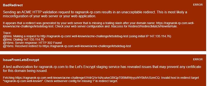

This worked! It helped with the installation, however my https still does not appear. I now get this error when I go to debug.
Thanks in advance for help and apologies that it doesn't openly make sense to me at first glance.
You have configured the virtual host to redirect requests from http://ragnarok-rp.com to https://ragnarok-rp.com but you have another redirect in that virtual host redirecting again to https://ragnarok-rp.com so you have a funny loop. You should fix the conf in your Virtual Hosts.

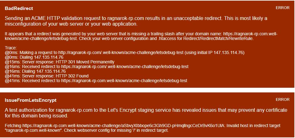

A slightly different error.
You must reload or restart Apache.
