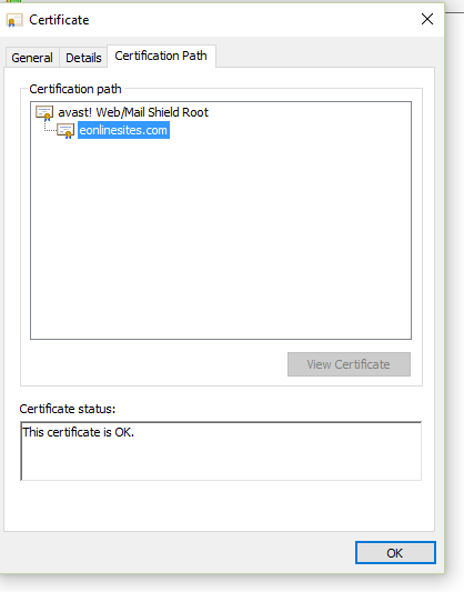

I was just coming here to say that in Internet Explorer
I just rebooted my computer after what I thought the server went down after reboot of my home computer its back to normal so guess that was it anti virus Avast strikes again.
when I click on the lock here’s what IE its showing
thanks for the fast reply
mitch
Yeah, Avast is not exactly known for their stable and secure MitM proxy. :blush:
… or really for being seucre at all. :unamused:
