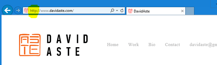

Yes so basically my whole goal here was to get the "verified" like the screenshot here, that how I found out about this place actually
Screen Shot 2022-01-20 at 12.46.43 AM
Connect to:
[https://www.davidaste.com/]
There you should see a similar lock (and verification).
The "problem" comes in with the insecure site:
[http://www.davidaste.com/]
It doesn't forward to HTTPS [and remains insecure].

Ok so I can't "verify it" aka stop showing it's an "insecure site" ? or what should I do?

But technically you already do have a validated site.
