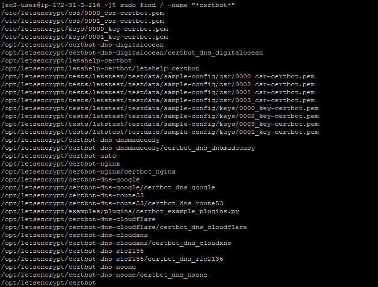

I try sudo find / -name "*certbot*" , it show
It looks like you have it in /opt/letsencrypt, so you could try sudo /opt/letsencrypt/certbot-auto renew.

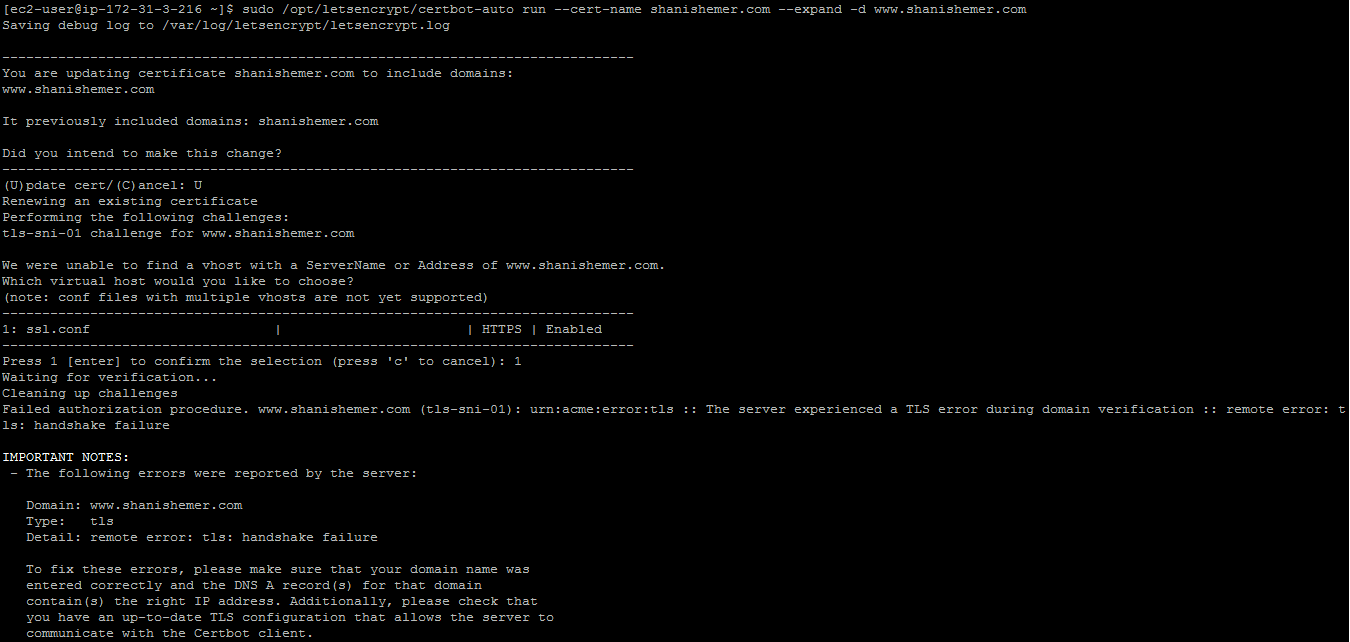

You most likely just need to expand your current certificate to include the www form of your website to fix your problem. The following command will generate the new certificate you need:
sudo /opt/letsencrypt/certbot-auto run --cert-name shanishemer.com --expand -d www.shanishemer.com
Depending on how your certificate was initially issued, you may also need to run sudo service apache2 reload afterward for Apache to start serving the new certificate, but certbot will most likely do this for you.
@Patches, also, this command will not work with a CDN if the original certificate was obtained using --apache or something, because it will try to use TLS-SNI-01, which can’t work behind a CDN.
@DuongTuGiang, you should also show us the output of cat /etc/letsencrypt/renewal/shanishemer.com.conf so that we can see how the certificate was originally obtained.

I try history | grep certbot only show
for sudo /opt/letsencrypt/certbot-auto run --cert-name shanishemer.com --expand -d www.shanishemer.com
and I try cat /etc/letsencrypt/renewal/shanishemer.com.conf
@schoen was partially correct. Your first certificate was issued in a manner compatible with CloudFront. I just told you the wrong way to reissue it. :flushed:
The command you want is:
 sudo /opt/letsencrypt/certbot-auto run --cert-name shanishemer.com --expand --webroot -w /var/www/html -d www.shanishemer.com
