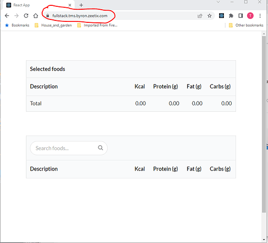

I appreciate that this issue may well lie in the intersection between the server and the IDE (VSC). I'm using an app described in "Fullstack React". Once I've published the app (using yarn build), the published app works without complaint at https://fullstack.tms.byron.zeetix.com (screenshot below).
I interpret this to mean that my certificate is valid while being accessed through the usual standard port (443). As noted upthread, I'm using an Apache webserver with the usual virtual host rewrites in /etc/httpd/sites-available and /etc/httpd/sites-enabled. I've included the result of certbot certificates below.
When I append :3000 to the URL, the result says 'Invalid host header` (see screenshot below).

Successful screenshot:
